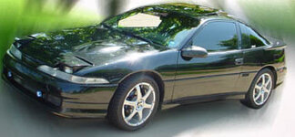

yea, i did that in my 1g
i still have to go back and fix the rear wiper switch that i missed. i think it was only like 2 leds, then the one in the boost gauge. i love it though, very subtle, unless you know the car ;)
