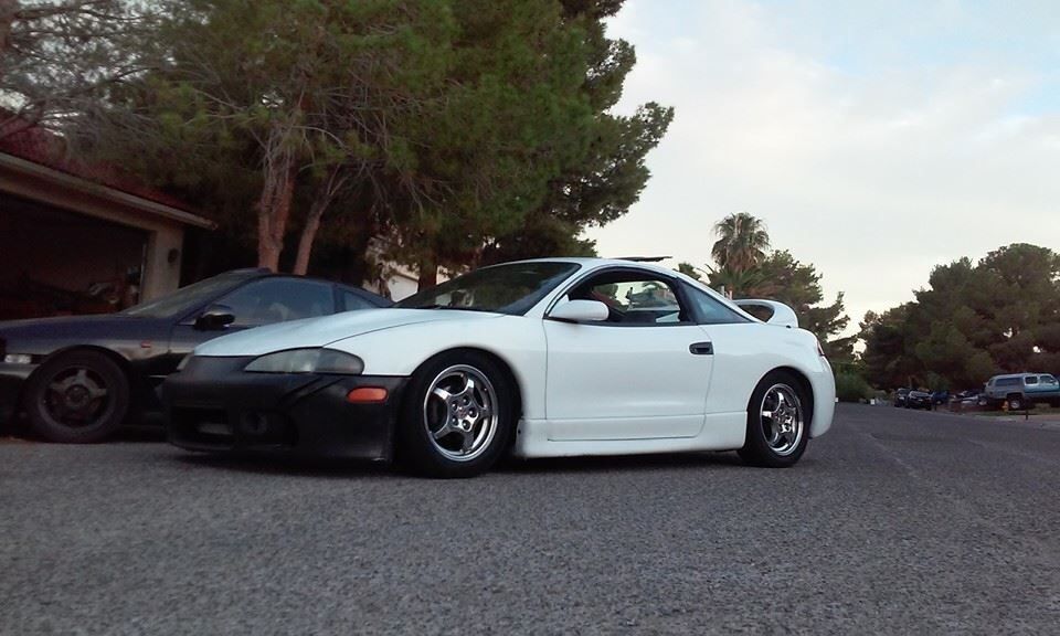

- Background
- I purchased this car in October 2014 (first turbo dsm) When i first got the car for 2700, it had some problems. Transmission wasn't the best, rod bearing in cylinder 1 was shot (happened 2-5 weeks after having the car). After having the car for about 5 months my tob and clutch gave out from racing a monte carlo ss, but i won the race lol Car was down for a good 2 months before i had the funds to get it back up. I've raced many different cars and can say that my W-L ratio is in the positive side. My plans and goals for this car is to make a fast FWD that can out run the AWD dsms in Las Vegas. My first goal is to hit 13s then hit 12s. My first run at the track will be on the 18th of september so i'm very excited! I'm going to be buying a gopro so you guys can see how I do. Hope you guys enjoy following my build and follow me through my journey.
